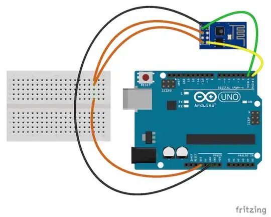

WIRING SCHEME 1
!! I have the green wire attached to pin 3 on the Arduino Uno and the yellow wire attached to pin 2; not 1 and 0 as the picture suggests !!
WIRING SCHEME 2
Same wiring as above, but I have RX and TX reversed. The green wire is attached to pin 2 and the yellow wire is attached to pin 3.

On your "WIRING SCHEME 1" you are using the arduino's Hardware serial port to talk directly to the device as if it was connected through a TTL cable or FTDI cable.
This means that the arduino device would in theory read from the hardware when talking too the ESP8266, if you have another arduino or a TTL cable, try and connect it to gate 2 and 3 on the "main" arduino and you should get a similar result as for your example result 2. Since you would that way proxy through the arduino. If not that would be a place to start debugging.
Beside that i could only recommend you in investing in either a TTL 3,3v or a logic level converter. When i got my cable everything worked out of the box.
