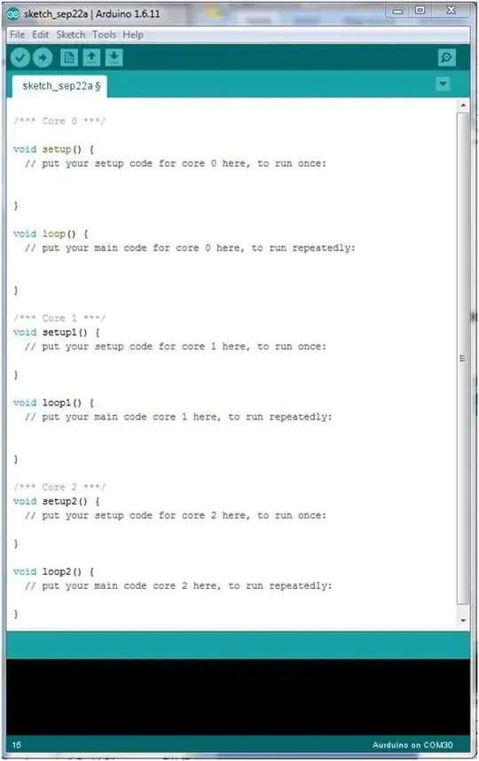

There's one Arduino-like product that certainly could enable multi-threading, as it is multi-core: the Shield Buddy TC275.
Core setup and loop functions
So basically you have three setup() functions, and three loop() functions. True multi-threading.
