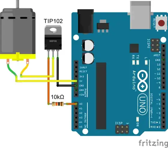

For energy-efficient switching (along with relatively high-current capability), I recommend using a Darlington transistor connected to one of the output pins (digital for on/off, analogue for variable). Then you would just call pinMode(A0, OUTPUT); followed by digitalWrite(A0, HIGH); Here is a sketch I made demonstrating what I mean: enter image description here
Note that a normal transistor would draw more current from the Arduino's pin, which could be bad for the Arduino, and which would waste energy.
