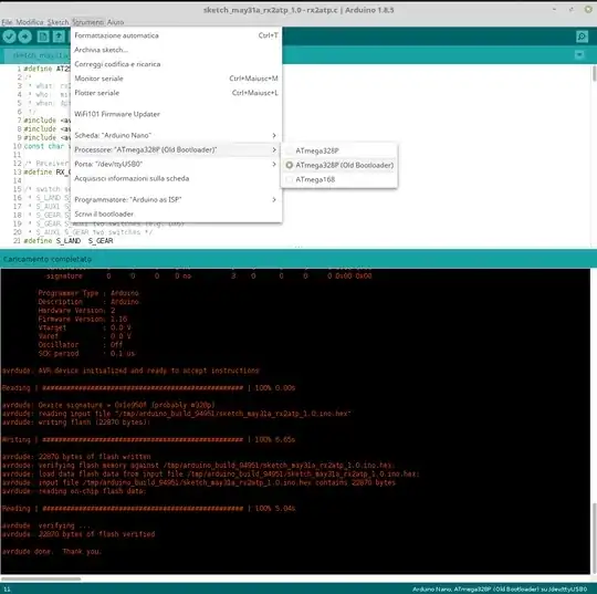

For me the problem was the selected "processor" type.
I had to change it to 328p (old bootloader).
Also, raise the IDE's verbosity, in order to have a nice progress bar when loading the sketch.
My specs:
  • OS: Linux Mint 18.3
  • Linux kernel: 4.13.0-37-generic
  • Arduino IDE: v1.8.5
  • board: the cheap and common Nano Chinese clone
  • USB to serial chip: CH340
