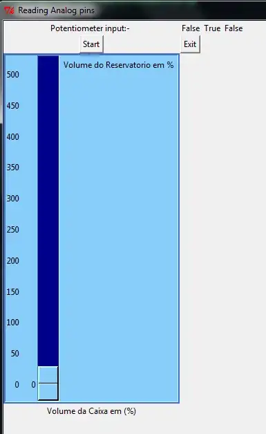

Is there any trick in python code that can solve my problem ? Because I did a lot of research on the internet and I could not get done, as you can see in image 2 when the state of the second digital pin changes, a label changes to True, and in the scale code this corresponds to the value 100, but it's still on the 0 mark.

in your code:
pos2 = d8.read()
print("pos2 is {} type {}".format(pos2, type(pos2)))  # This way, you'll know the var type you're getting on the console
    if posX == True:
        posX = int(posX)          # You then cast to an integer
        posX = 100                # You discard pos2 value by setting it to 100
        brightnessScale.set(posX) # You set the scale always to value 100
By adding the print line, you can ensure the variable value and type.
Then, you may have to adapt your if statement accordingly.
Beware what you're doing then with those 2 lines reaffecting posX, this is probably not what you want to do before updating the scale.
