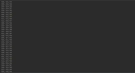

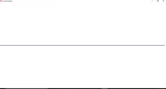

So after working with the answer given on the post I ended up with a Line graph that is not reactive, I understand that I have to tweak the code to suit the range of values I am getting which is shown below. I increased the limit as indicated by @patthoyts but I still couldn't get either lines to show up on the canvas and to even be reactive ( what i mean by that is to respond to the movement of the sensor). Also, do bear with me Editors!, if I'm going about editing this question the wrong way, is just that I'm quite desperate to have this issue resolved. Does anyone have any clue as to how I could resolve this issue. Thanks PS: I added both images , that of my data stream and the image on the canvas. enter image description here enter image description here

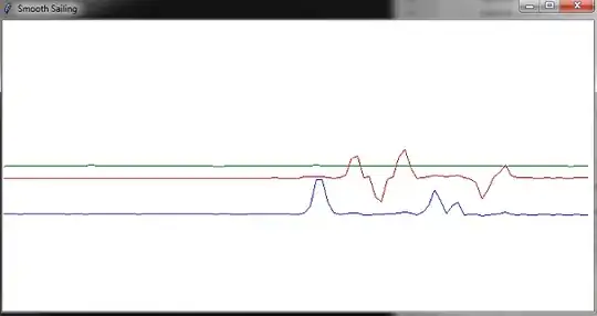

To generate a useful example I've setup an Arduino Nano with a magnetic orientation sensor and have it output 3 values per line for the X, Y and Z field strengths. It prints 1 line every 50ms and the following python tkinter script plots this. It started as your python code above but it has been reworked to be more pythonic. The result looks like this: screenshot of tkinter plot
Call the script with the comport and speed. eg: python magplot.py COM21 19200

Update
Looking at the updated question it is clear that the new Tkinter code is not updating the display. In all windowing systems it is essential that the application thread is allowed to process events regularly. This is why the example code above uses the Tk after() method to add calls to the event queue. The read_serial() function checks to see if any data is available and if not schedules a retry later. This is done by using after() to request the same method is called again in 10ms time. During that 10ms delay the Tk application processes all the other windowing system events like mouse movement, keyboard input and crucially expose and painting events.
The same method is used to call the replot() method once we have updated the list of data items. In this case after_idle() has been used which means schedule this function call as soon as nothing else is happening.
The act of changing the canvas line coordinates will cause further events to be raised by Tk which affect the display only once they are processed by the event loop. If we never process the events, nothing will appear on screen.
