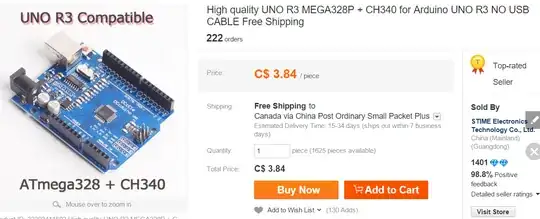

I am trying to understand what is it that this product offers:
Arduino UNO R3
  1. Why it says "For Arduino UNO R3"? 2. Isn't it actually an "Arduino UNO R3"? So why it says "For"?
  2. What are MEGA328P and CH340? Does "Arduino UNO R3" comes with other chipsets?

It sounds to me like an Arduino Uno clone.
I would read that as "For Arduino UNO R3 projects" (ie. Uno-compatible).
No, it's a clone. Or not really a clone (see below) because they used different hardware. It is compatible with the Uno in most respects.
What are MEGA328P?
That is the main chip on the board (actually an Atmega328P).
and CH340?
They have saved money by using a CH340 USB-to-serial chip instead of the Atmega16U2 used on genuine Uno boards. You may need to install a different driver to make that work. I disagree with the other answer(s) that this is a separate board or chip. It is clear from the photo of the chip near the USB socket that it is a CH340 chip there. See, for example https://hackaday.com/tag/ch340/ from which I quote:
The cheapest USB to serial chip on the market appears to be the CH340G, available for 20-40 cents apiece from the usual retailers. There is, however, almost no English documentation, and the datasheet for the CH340 family doesn’t include this chip
They used it because it is cheap.
Yes the genuine one comes with an Atmega328P (main processor) and Atmega16U2 (USB interface).

The board in the picture is not an official Arduino board. It is a clone. You will note that in the picture the board does not say "Arduino" It may be 100% compatible or it may not, you have to decide if the low price is worth it.
If you want an official board you should check either http://arduino.cc or http://arduino.org to find official distributors. (see this question for information about why there is both arduino.cc and arduino.org).
