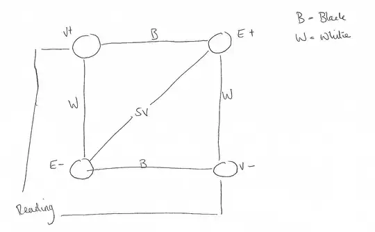

I've arranged my load cells on the scale into a Wheatstone Bridge, and I can get some readings just by taking a voltage reading from the two cells marked V+ and V-. The board has terminals that are linked to a INA125p, and the pins should give an amplified reading.

My question is: Based on the tutorial and the drawing above, am I taking the readings from the correct place? Are there any things I'm obviously doing wrong with the circuit itself? If the circuit is correct, how would I go about trying to get correct readings from the scale when I add weight to it?
I apologise for the vague nature of this question, but I am a complete beginner trying to figure this out, and I am struggling to follow the tutorial. I'll try and provide any additional information that you need.
EDIT - I have a Salter SAL-3003 SSSVDR08 scale.
Each load cell has 3 cables, Red, Black and White. The red ones are the ones marked with the V+, V- etc. On the original board, they were wired in threes.

Fixed (to some extent)! Faulty connection between the INA125p and the plint it was sitting in. I refitted it and i'm now getting varied readings with the scales, but that's to be expected with the noise the INA125p generates.
