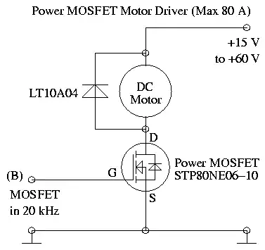

MOSFET motor driver - from here - section 8.
Voltages and part numbers are for their example - select to suit.
A NPN biploar could be used with the addition of an input resistor to the transistor base.

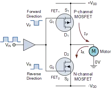

Bidirectional driver - if you want the driver to be able to drive a load high and low this circuit will work. from here
The input gate is in this case the internal processor driver. The two MOSFET gates connect directly to the processor pin. Vdd should usually be no higher than processor Vmax_drive_out. Slightly higher can be made to work with suitable design. Much higher voltage loads can be driven with this circuit (or similar) plus one extra transistor.

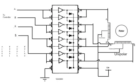

A buffer such as a ULN2803 (and other family members) will drive 8 channels x 500 mA/channel and several can be paralleled.
A ULN2803 is essentially 8 x "Darlington" transistors with emitters connected to a common ground, 8 x "open collector" (unconnected) collectors, and 8 flyback diodes to deal with over voltage spikes (use optional). (There is a ULN280x family with slightly different input characteristics).
This device provides a reasonably priced means of providing 8 x 500 mA pull down drivers. A load connected from an output to V+ is turned on when the input pin is driven high. Once you've used one a few times you'll find them trivially easy to use and very useful. (There is also a ULN200x family with 7 channels per package).
YouTube "how to" video
Driving a stepper motor
