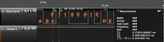

The start bit is absolutely essential in serial comms. In the graphic below, the start bit is marked "B" - which distinguishes it from "idle" data which is "A". Once received, the receiver then waits 1.5 bit times and starts clocking in the remaining bits. (Starting at "C" in the diagram, and then moving on for a total of 8 bits).
One serial byte
Without a start bit, how would the receiver know when the byte started? Imagine you wanted to send 0xFF (all 1 bits). Without a start bit that would be indistinguishable from the idle state.
In the graphic, "D" is the stop bit. Why have a stop bit? We need one (which is a "1" bit), so that we can detect the transition from the stop bit in the previous byte (a "1") and the start bit in the next byte (a "0").
In the graphic, "E" is the start bit for the next byte.
