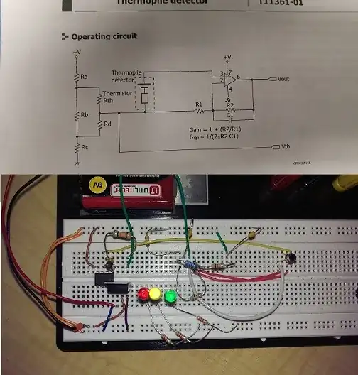

I'm making a simple Infrared detector using a thermopile. I have a few extra capacitors than what that schematic says. I'm currently following another, but this is the gist.
Schematic and Breadboard- Breadboard and Schematic
I can add breadboard picture if needed. I don't have 10 points in this Stack so I can't post more than 2.
I'm using a 9V battery through a 24v - 5v regulator (had one around) to power my op amp and schematic. The signal from the OPAMP will be between 0-5V so voltage hasn't damaged the Arduino Uno. The final project will be something like: output > A then power green, A < output < B power yellow, B < output red.

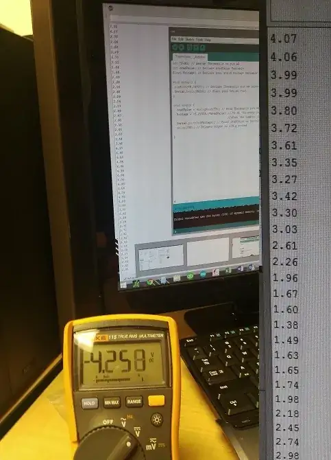

The issue is that I'm getting an oscillating value from my Serial Monitor that goes from 0 to 1023 (or I have a conversion to change it back to output voltage. So 0V to 5V. See code).
It does this oscillation when I have the board connected to any of the AX pins (X=0-5) or nothing plugged in at all (I understand it will output weird numbers with the pin floating).
I had a picture of the serial monitor but I don't have 10 points to add more than 2 pictures. Please see image below
I know that the output from the OPAMP works because when I use a VoltMeter to read the output, it works fine. 0.3XXV when no flame, 5V when flame is directly on top of my theromopile. Serial Monitor and VM
Would anyone happen to have a suggestion to why the Arduino is acting this way? The volt meter reading is directly out of the Op amp pin 1. no more than 2 links. AD822 op amp

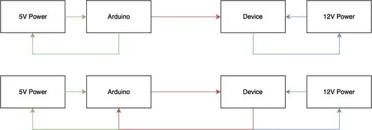

It seems you haven't connected the circuit ground to the Arduino ground. This is essential to complete the circuit between your breadboard and the Arduino. Without the ground connection the electrons that you send to the Arduino have no way of getting back again.
Here's a couple of diagrams that I drew for another question which deals with the Arduino driving a remote device, but the theory holds true no matter which way around it is.
In that diagram the red arrows (not the aerial display team I hasten to add) represent the connection between your breadboard circuit and the Arduino. Without the ground connection there is no circuit, and a circuit is always needed for current to flow (and hence your signal). With the ground connection the red arrows become a loop which allows the current to flow and transfer your signal.
