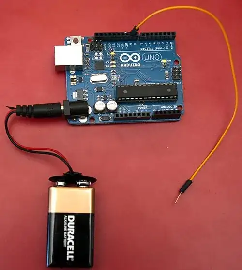

I had a toy project a while ago that generated AM radio.
Code
Code for Uno or any Atmega328 based boards:

Wiring
Plug a wire into digital pin 9:
AM radio
Theory
The 16 MHz clock is divided by 10 (that is, 1.6 MHz) and that is used to toggle pin 9 at that rate, giving a frequency of 800 kHz, since one toggle turns the output on, and second toggle turns it off.
Then by turning the output pin on and off slowly you effectively have "keyed" output.
Obviously this would not have a long range, but you could amplify the output signal.

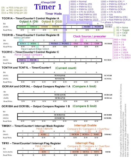

What does the timer code do?
It's a bit easier to understand if you look at the datasheet. I did a summary for Timer 1 (and the other two timers on the Atmega328) a while back.
Timer 1
Timer 1 chart
The lines assigning to TCCR1A and TCCR1B set various bits as per the chart / datasheet. Then OCR1A is the value that the timer counts to, zero-relative, so it counts to 10.
The prescaler is set to 1, so each "tick" is 1/16000000 of a second (62.5 ns). Count 10 of them and you have 625 ns per tick. The timer is configured to toggle an output pin automatically. Since it takes two toggles (on and off) for one frequency "cycle" the period is 1.250 µs. The inverse of that is 800000. Thus the output frequency is 800000 Hz (800 kHz).
