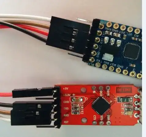

I have arduino pro mini 5V, 16M ATMega328 and CP2102 USB to TTL. I've wired them like this:
When I try to upload a sketch to the arduino board I'm getting the following error:
avrdude: stk500_getsync(): not in sync: resp=0x00
The board type and the serial port are correct. The sketch also compiles successfully and I've installed the CP2102 drivers. I've noticed that even if I unplug all wires from the arduino board(and just leave the cp2102 connected to the PC), I'm getting the same error again. I'm using Windows 7.
Anyone else encountered the same issue?

It's hard to tell from your pictures, but are all the header pins soldered to the boards? If not, they need to be: there's no chance that the proper electrical connections will be made reliably if they're just inserted loosely into the holes.

This error means that the program responsible for uploading (avrdude) can not communicate with your arduino.
Did you reset the board just before programming? The reset pin of the arduino seems unconnected in your picture; so the board wouldn't be executing the bootloader when the serial cables expects it to.
Try either to reset the board manually just before programming, or connect the rst pin.

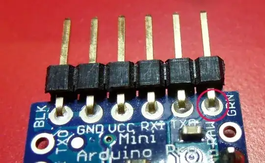

As some of the other answers have said, you may not have soldered on the header pins. You can't just push them into place and hope for the best. See my Pro Mini:
Arduino Pro Mini
My soldering is reasonably neat, however you can see the solder come through to the other side.

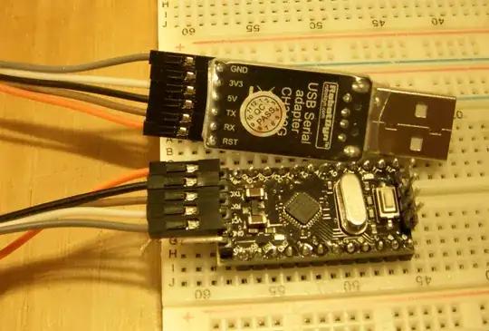

To solve my sync issue I added a connection from USB serial adapter RST to ProMini DTR pin. I'm using Linux Mint 18 OS with Arduino IDE 1.8.5 - My other Arduino clones (UNO_r3 and Nano) uses the CH340G chip so I knew I had working drivers. Sorry for the picture quality, my old camera and I don't know how to balance LED light bulbs. The pins from USB to ProMini are: (U)GND-(P)GND; (U)3V3-(P)no connection; (U)5V-(P)VCC; (U)TX-(P)TX; (U)RX-(P)RX; (U)RST-(P)DTR. Hope this helps. 73 AB1OP_Ralph
