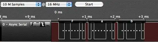

A picture is worth 1000 words, so they say, (1024 words if you work with computers) so I'll post some pictures ...
I set up my Uno to send "Fab" at 9600 baud and captured the results on a logic analyzer.
Serial comms - 3 letters
The parts shaded in red are the "idle" period between bytes.
From the above graphic note that the Tx (transmit) data line is normally high (1) until it drops low to indicate the start of a character (byte). This is the start bit. Then the 8 data bits (indicated by white dots) appear at the baud rate (9600 samples per second). After that the line is brought high again. This is the stop bit (the red part). Then we see the start bit for the next character, and so on. The "stop" portion can be indefinitely long, however it has to be at least one bit length.

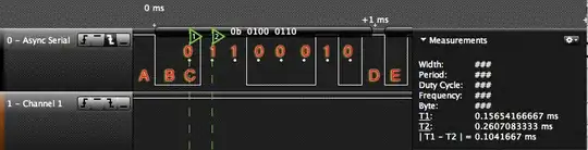

More detail for the first character (the letter "F" or 0x46 or 0b01000110) can be seen here:
Serial comms - a single byte
  • A - no data (Tx is high)
  • B - The "start bit". The line is taken low to tell the receiver that a character (byte) is commencing to be sent. The receiver waits for one and a half clock times before sampling the line.
  • C - First character arrives (the letter "F" or 0x46 or 0b01000110). There is no clock bit as such, the incoming data is simply sampled at the baud (transmission) rate. In contrast to SPI communication the data arrives least-significant bit first (in case you are not sending 8 bits per byte). Thus we see 01100010 (rather than 01000110).
  • D - The stop bit. This is always high, to ensure that we can distinguish between the end of this byte, and the start of the next one. Since the start bit is a zero, and the stop bit is a one, there is always a clear transition from one byte to the next.
  • E - The start bit for the next character.
You can see from the logic analyzer capture that T1 - T2 is 0.1041667 ms, and as it happens that is 1/9600:
1 / 9600 = 0.00010416666 seconds
Thus the rate of 9600 gives you the number of bits per second and the inverse is the time interval between bits.

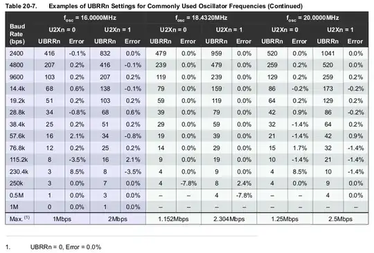

  • The clock rate is not exact on the Arduino, because the hardware has to divide the system clock down to get a serial clock, and the division is not always exact. There is almost always an error, the amount is given in the datasheet (figures quoted for a 16 MHz system clock, such as on the Uno):
    Serial baud rate error
