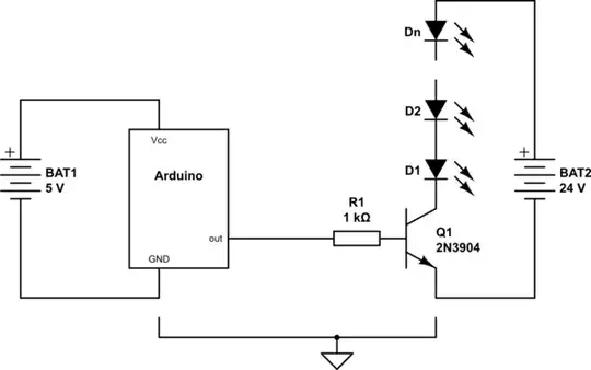

You'll probably want to use a transistor to switch it on/off. You could just use the Arduino's digital pin but they can only supply a limited amount of current. Transistors can work with larger currents. The Arduino switches the transistor and it powers the external circuit.
There are a couple of existing questions that may help you.
jippie's answer in the first link shows an example schematic for hooking up a transistor with a bunch of LEDs but you would replace them with your own circuit:
