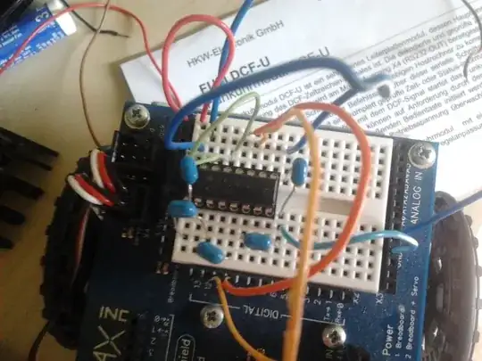

I didn't find answers which solves my problem with the max232 yet. I connected it like this to my Arduino uno, so my Arduino provides the +5V VCC and the ground: max232 connection Connection on board
The only thing what is differences are that I do a loopback at the RS232 side and I use 1µF for every capacitor even for the bypass one. I did a loopback so I can see if the max232 works. I don't get anything out of it when I send some data to it. I measure +8.7V on pin2 and -8.15V on pin 6.

What did I do wrong or is my max232 broken?

Now the loopback works thanks to the answer below. Now I replaced the loopback with the module FUM DCF-U. The loop code has changed to this:
void loop() // run over and over
  if(Serial.available())
    Serial.println(Serial.read());
The problem is that the result is '000000000000000000000000000000000...' in a fast rate and not every second.
The module gets its 3.3V and is connected to the same GND as the MAX232.
Pin connections:
Arduino - MAX232
11 - 11
0 - 12
MAX232 - FUM DCF-U
14 - 3
13 - 4
Thanks in advance
