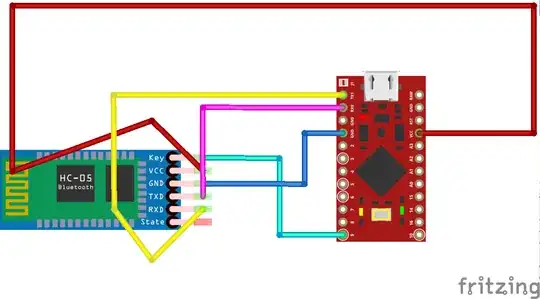

So I stumbled upon this thread while having similar problem, but with HC-05 module. So because I have too much free time on my hands during finals (no I don't) I decided to create a small github repo that might help someone sometime. https://github.com/Sackhorn/HC-05-Pro-Micro-Hookup
The code is:
//Writen for pro micro
//These proved to be usefull
//http://arduino.stackexchange.com/questions/1471/arduino-pro-micro-get-data-out-of-tx-pin
//https://forum.sparkfun.com/viewtopic.php?f=32&t=38889&sid=8178cdb38005ff33cc380a5da34fb583&start=15
void setup()
  pinMode(9, OUTPUT);
  digitalWrite(9, HIGH);
  Serial.begin(9600);
  Serial1.begin(38400);
void loop()
  //Serial1 is the physical Serial Connections on TX and RX pins
  if (Serial1.available()) Serial.write(Serial1.read());
  // Serial is from my understanding the virtual connection with computer via USB
  if (Serial.available()) Serial1.write(Serial.read());
