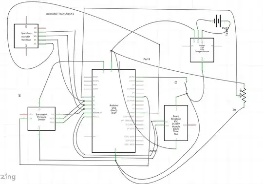

In this diagram the "pressure sensor" is really a OLED that operates via MOSI and MISO.

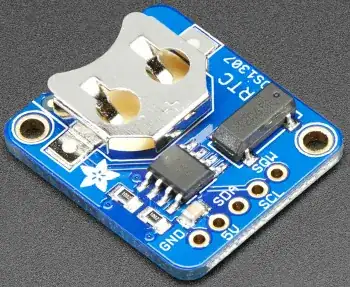

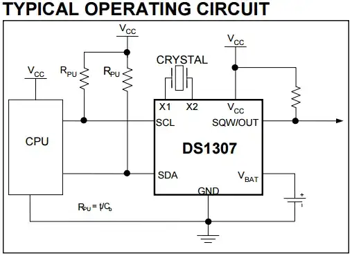

The RTC board has a battery holder and requires the button battery to be fitted in order to retain the time and date value. As shown in the Datasheet, this battery is for the RTC chip only.
DS1307 Circuit
The Adafruit board requires a CR1220 button battery.
Adafruit DS1307 board
The Adafruit webpage mentions the following:
Note: This product does not come with a CR1220 coin cell battery.
(Providing that it works when the Arduino is powered up) It sounds as if the battery for the RTC is either:
  • not present
  • not connected (not inserted correctly or not making proper connection)
  • inserted upside down
  • a track on the PCB is broken or shorted
  • the battery is flat
The battery should be inserted so that the flat + side is UP. I suggest that you use a DMM to measure the RTC battery voltage at the RTC IC. Place your +ve probe on pin 3 of the IC and the -ve probe on pin 4. It should read slightly above 3.0 Volts.
I also recommend that you disconnect all of the other periferals so that you just have the RCT connected to the Arduino. Then use a known working program such as the one in the Adafruit tutorial to verify that your RTC is working correctly. You should be able to disconnect the USB and then reconnect it and find that the RTC is still holding the correct time.
