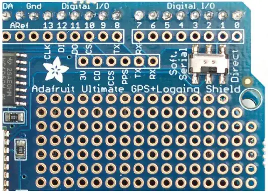

Looking at the PDF for the Adafruit GPS shield, pin 7 is indeed hard wired to Rx and pin 8 is hard wired to Tx.
Adafruit GPS shield PCB
These can not be changed.

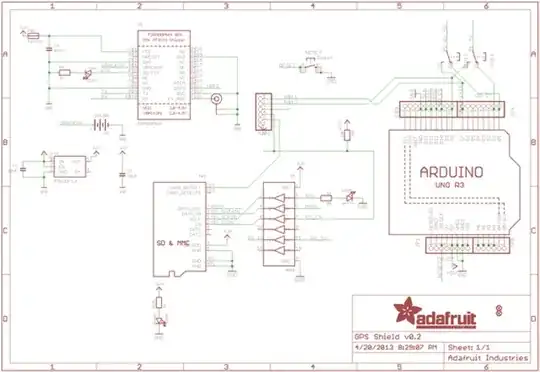

The schematic of the Arduino GSM shield: enter image description here
The schematic of the Adafruit GPS shield: schematic of the Adafruit GPS shield
