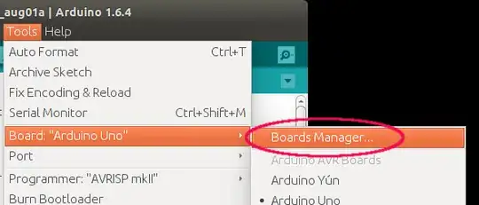

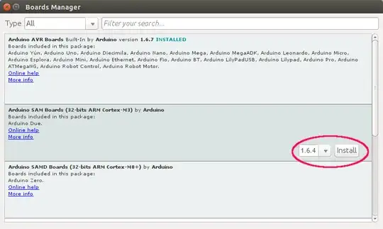

Also, why do I not have a "Due" in my Board menu?
See:
Board manager menu item
Then:
Board manager install
