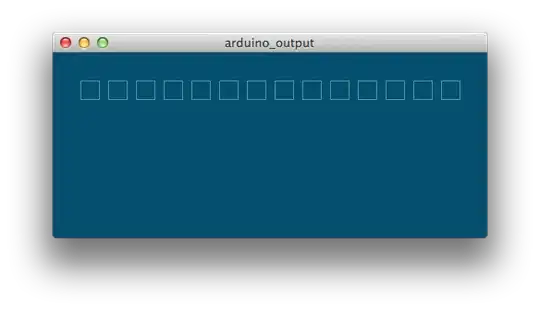

Relaunch the Processing application. File -> Examples..., opens up a window, scroll down to Contributed Libraries, open that, open Arduino (Firmata), open the arduino_output example. Hit the Run button, and after compiling you should see the window below:
arduino_output window
HTH.
