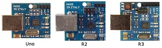

  • The rotation of the ATMEGA8U2 (the little chip near the USB port) was changed by 45 degrees. enter image description here
  • Four solder pads (JP2) were added, connecting to pins PB4 to PB7 of the USB ATMEGA." enter image description here
  • Instead of R1's solder pads, R2 adds header pins to the USB ATMEGA ICSP. enter image description here

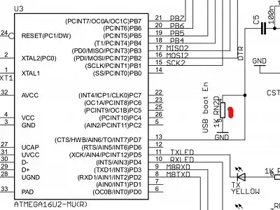

  • A resistor was added between the DTR (HWB) line and the ATMEGA PD7 pin. enter image description here

  • The rotation of the ATMEGA8U2 was changed back by 45 degrees.
  • The ATMEGA8U2 was changed to an ATMEGA16U2.

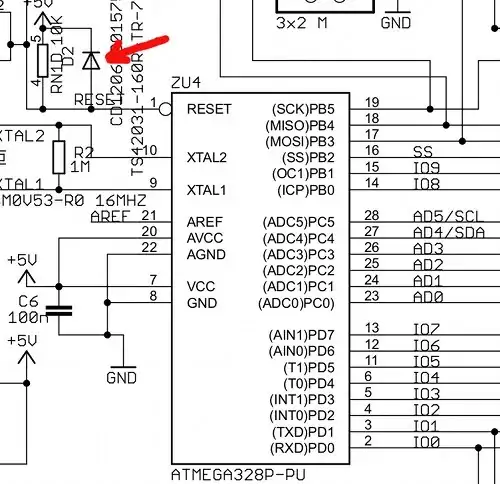

  • A diode was added, wired from +5vdc to the reset pin, cathode to +5vdc. enter image description here

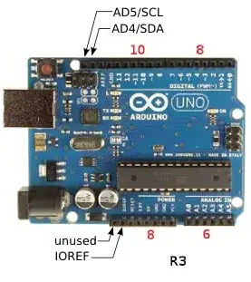

  • The 8 pin connector that contains Arduino pins 8 was changed to 13, GND and AREF for a 10 pin connector. The extra 2 pins are connected to AD4/SDA and AD5/SCL. Also, the 6 pin connector that has the reset pin connected to it changed to an 8 pin connector. One of the new pins on this header is the IOREF pin that allows shields connected to the board to adapt to the voltage of the board. The second pin is not connected and reserved for future use. enter image description here

  • The revision 3 board changes the 8 pin connector that contains Arduino pins 8 to 13, GND and AREF for a 10 pin connector. The extra 2 pins are connected to AD4/SDA and AD5/SCL. These are the two analog input pins that can be used for I2C.
  • Revision 3 boards change the 6 pin connector that has the reset pin connected to it to an 8 pin connector. One of the new pins on this header is the IOREF pin that allows shields connected to the board to adapt to the voltage of the board. The second pin is reserved for future use.

  • Both revision 2 and 3 boards add a 1k pull-down resistor to the DTR (HWB) line coming from the USB ATMEGA microcontroller – from the PD7 pin.
