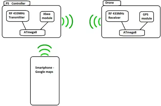

I want to make a drone project, and to that I will use arduino as the platform. My plane is to use a Play Station controller to control the Drone in the air. In addition to that I want to connect a GPS-module. My question goes, is it possible to transmit the longitude and latitude from the GPS via the RF 433MHz to the receiver? When received the longitude and latitude how can I transmit them further to the Smartphone and display the data on google maps? I suggest it could be possible through the Xbee, but I am not sure.
I would like if someone can confirm my idea, if not bring me a better way to do that.
In the image below, you can see the diagram of my design.

If you are using Xbee modules in your project, why add 433MHz RF, just for the sole purpose of transmitting the location? With the 433Mhz, you will have to implement error-correction yourself.
Your design suffers several redundancies that should be fixed. First of all, you have an Xbee (only one, not a pair) and a a 433 MHz transmitter/receiver combo. Why not just add another Xbee to the drone and remove the RF combo? That would save a little battery life for the receiver end, and a lot of your time. You'll also get two way communication with error checking. Although an Xbee would increase your project size a little, if you manually wired the Xbee instead of a shield (3.3V), it would save a lot of space.
As some people point out, Bluetooth is a viable option that's fairly small and low cost. However, it would suffer shorter ranges and it would need a special configuration on the host side for a BT stack.
