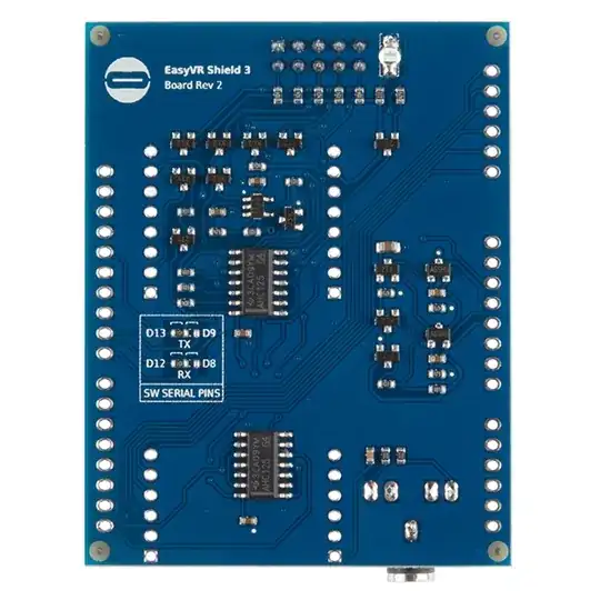

This block of code is determining how to set up the serial communication. The first two if statements are for different boards, but the third one sets up the software serial connection... and it says there are two options, pins 12/13 OR 8/9! If there are two options, there must be a way to switch it on the board itself.
And sure enough! Check out that white box labeled "SW Serial Pins". Jackpot!
Here's what the manual has to say:
On the bottom side of the board there are two SMD resistors that you can move to select the two pins of Arduino that the EasyVR will be connected to when in Software Serial mode (Mode Jumper on SW).
  • RX – Software Serial Receiver pin
    • D12 – Use digital pin 12 as serial receiver (default)
    • D8 – Use digital pin 8 as serial receiver
  • TX – Software Serial Transmitter pin
    • D13 – Use digital pin 13 as serial transmitter (default)
    • D9 – Use digital pin 9 as serial transmitter
The choice of pins 12-13 is maintained for backward compatibility with the previous hardware revisions of the EasyVR Shield. However those pins may also be used for the SPI interface, so another choice of pins 8- 9 is provided. If you want to use different pins make sure the receiver pin supports change interrupts.
