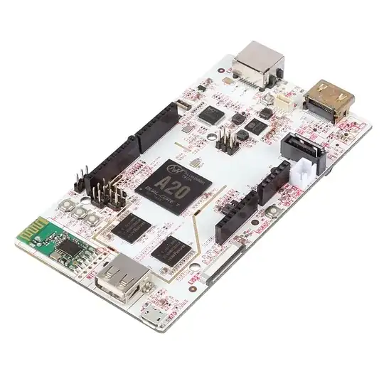

There is a board called the pcDuino that can run multiple variants of Linux such as Debian, Ubuntu, Open WRT, LEDE, Raspian PIXEL (just to mention a few). This board is not a native Arduino, rather Arduino AtHeart, and is made by LinkSprite.
pcDuino
