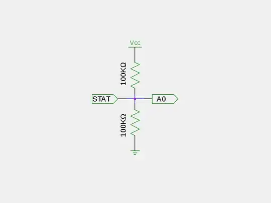

Another option is to use an analog input pin instead of a digital input pin.
Create a balanced voltage divider using equal high value resistors (say 100KΩ each). Attach the mid-point to the ADC pin, and one end to each of Vcc and GND. The incoming status signal goes to the ADC pin:
Perform an analogRead() on the pin. You will get one of 3 results:
  • Close to 0 = LOW
  • Close to 1024 = HIGH
  • Close to 512 = HiZ
When the pin is in HiZ the resistors will hold the voltage at around 50% of Vcc. When the pin goes HIGH it will pull the pin up and override the resistors, giving a high value reading. Similarly, when the pin goes low, the resistors will be overridden and a low value reading will be given.
