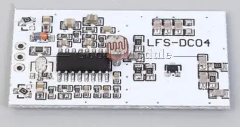

Here is a microwave RADAR motion-sensing module that you might find useful. You could mount it right by the stairs.
http://www.ebay.com/itm/262662221979
LFS-DC04 2.7GHz Microwave Radar Module DC 5V 360 Degree High Level Signal New
Product Introduction:
1.Model:LFS-DC04
2.Frequency:2.7GHz
3.Size:40*22mm
4.Input Voltage:DC 5V
5.Output Type:level signal output
6.Connection Method:VCC,GND connect with positive negative input, OUT,GND signal connect with output
7.Installation Height:1-3.5m
8.Sensing Ditance:5-8m
9.Delay Time:30s(quick testing mode is 4s)
10.Sensing Angle:360 degree
11.$1.59 price via the slow boat
