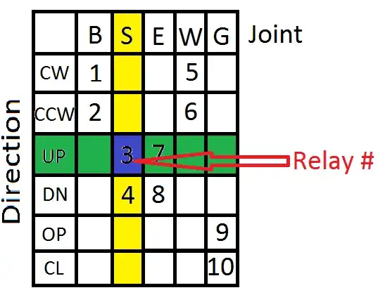

Ok, now to my question! As it stands now, the program works well, but is not intuitive. Each joint has 2 relays associated with it: one for each direction of travel. There are 5 joints total in the robot arm. I am able to use the program easily since I know directly (from setting up the HW and then the SW) which relays correspond to which Arduino pins and of course which relays correspond to each joint. I'd like to make the program more intuitive where instead of "2,2,0,0,3,4" input string for example, the user would do something like "B,CCW,S,CW" where B is for B = base, CCW = is counter clockwise etc.

Basically, I need a 2D table where the joint and direction are input and then the SW associates one particular relay with those inputs. Please see the table below for a graphical example of what I tried to say above.
One possible solution that I dread and saw mentioned was to use a ton of if else-if statements.... I dread this since I want to be able to input any joint in any order and thus it seems like when the code parses the input string for the ith relay, it would have to check ALL of the conditions to see which joint it is, which direction etc. For example, I think I could minimize the # of if statements needed if I only entered in the input commands in a certain order: base first, shoulder next, etc. Doing so however, limits the intuitiveness of the program.

Another thing you can consider is to define a struct. This is a compound variable that contains other variables of different types.
You could define a struct to describe the joints of an arm:
struct arm {
    int base;
    int shoulder;
    int elbow;
    int wrist;
    int grip;
Which you can then assign as variables:
const struct arm left_forward = { 1, 3, 7, 5, 9};
const struct arm left_reverse = { 2, 4, 8, 6, 10};
You can then get at different pins by using such things as:
digitalWrite(left_forward.shoulder, HIGH);

Another option, which might be far more logical, is to turn the whole thing inside out. Define a "pin pair" structure that defines the two pins for a joint:
struct pinpair {
    int forward;
    int reverse;
Then an arm consists of 5 "pin pairs":
const struct pinpair leftarm[5] = {
    {1, 2},
    {3, 4},
    {7, 8},
    {5, 6},
    {9, 10}
So to move the left shoulder forward it would be leftarm[1].forward and to move the wrist backward would be leftarm[4].reverse.

I suggest you turn this into a simple 1D table by using two different separators, for example ‘:’ between joint and direction, and ‘,’ between consecutive movements. Then, instead of “B,CCW,S,CW” you would type “B:CCW,S:CW”. For parsing the string, you split at the commas, and consider the pieces between the commas as single items. In other words, “B:CCW” would be the name for relay 2, and you do not try to split it further.
Here is a simple method to map the strings to the relays:
const char * const relay_names[] = {"", "B:CW", "B:CCW", "S:UP",
    "S:DN", "W:CW", "W:CCW", "E:UP", "E:DN", "G:OP", "G:CL"};
// Return the relay number.
int get_relay(const char * name)
    for (int i = 1; i <= 10; i++)
        if (strcmp(name, relay_names[i]) == 0)
            return i;
    return -1;  // meaning invalid

In C/C++, multi-dimensional arrays are represented as arrays of arrays of arrays ..., for the number of dimensions needed (the last subscript varying most rapidly as you step through the stored elements in RAM).
The array you described is a sparse array; not all cells hold valid data. To simplify (and that's a relative term!) the storage and the code, I would arbitrarily assign each joint a forward and a reverse direction, reducing your 10-row sparse array to a dense array of only 2 rows. You can then, if you wish associate joint-relative motionss (up/down, open/close, etc.) with forward/reverse. Then you can find the pin # for a given joint relay by the joint name and direction as RelayPin[<direction-name>][<joint-name>]. A downside is that writing RelayPin[DIR_OPEN][JNT_ELBO] looks like nonsense but actually executes, though maybe not in the direction you think you meant.
This code snippet defines a 2D array of joint-relay pin numbers, with an example of enabling one of the relays:

// Joint table - each element is a digital pin number
uint8_t const RelayPin[DIRECTIONS][JOINTS] = {
//  B  S  E  W  Ga
   {1, 3, 7, 5, 9}, // forward
   {2, 4, 8, 6, 10},    // reverse
// Example of enabling motion to raise the shoulder:
digitalWrite(RelayPin[DIR_UP][JNT_SHOU], HIGH)  // raise shoulder

The other answers have presented some good techniques that are flexible enough to be adapted to other, similar problems. By contrast, the following method is specialized to work with the particular chart of joint-letters and relay-numbers mentioned in the question. (It can be modified for other relay-number sequences, as noted in program's comments.)
Rather than requiring entry of verbose text like CCW, or obscure abbreviations like DN, OP, and CL, it accepts a + or a - to set motor direction, with “+” corresponding to choices CW, UP, and OP, and “-” corresponding to other choices. For example, the question's sequence “B,CCW,S,CW” could be written as any of “B-S+”, “b-s+”, “B- S+”, “B-,S+”, etc (ie, case is ignored, and spaces and commas are ignored before a joint-letter).
Note, the code as shown assumes each command-list line starts with a number that gives desired delay time in tenths of a second. For example, “23 e-s+” would run E down and S up for 2.3 seconds. The command-list “47” would sit idle (no motors on) for 4.7 seconds.
