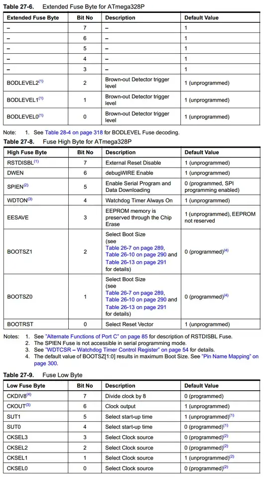

There are certain "fuse" settings which are set with a ISP programmer. However, there are only 24 of them (three bytes), and they largely relate to low-level configuration, and are not what I think you're asking:

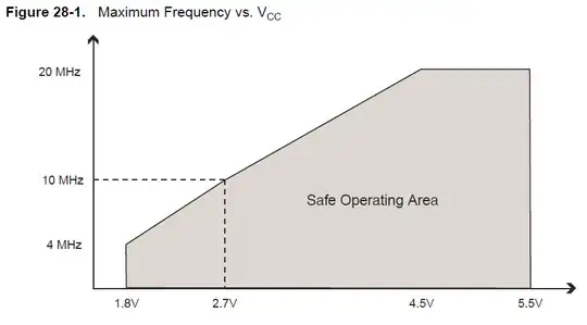

Note the below chart, in regard to your under/over volting the device for different F_CPU, indicates the relationship. As a result you find most Arduino's run at 5V and a clock rate of 16MHz. While there are some 3.3V variants that run at 8MHz.
Freq vs Vcc
However, the core library provided with the IDE typically has specific #if's for both 8 and 16 MHz F_CPU speeds, not using a formula in most places.
Hence it is possible to do what you ask. However, you will find the core library limitations affecting. Tipping the cost vs benefit ratio, to that of the very intent. And then likely one would leave the Stock IDE and core libraries to a more makefile method.
