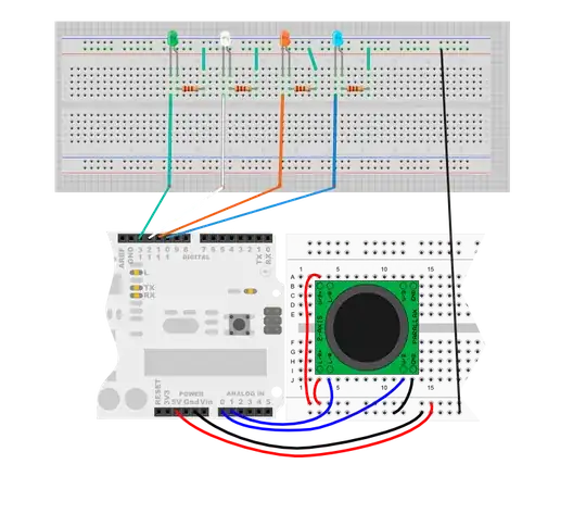

I made this video and github just for this about a year ago.
And here is the code:
2-axis joystick connected to an Arduino Micro
to output 4 pins, up, down, left & right
If you are using pull down resistors, change all the HIGHs to LOWs and LOWs to HIGH.
This skectch is using pull up resistors.
