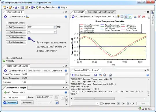

  • MegunoLink ($39.95; Lite free) - plotting, logging, programming, reporting and more.
    MegunoLink

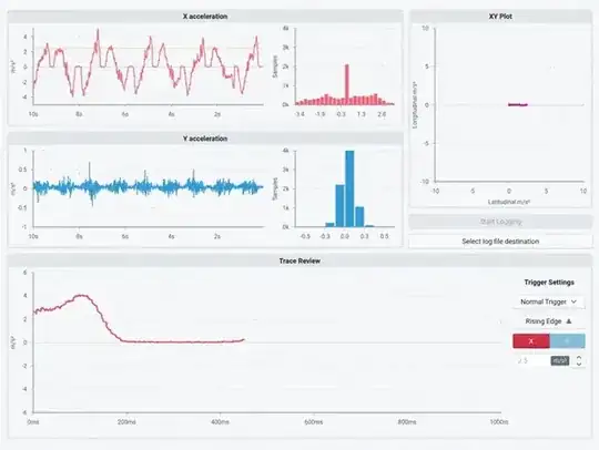

  • Electric UI ($80; free for students) - cross platform, fully featured code based GUI framework for hardware.
    Electric UI

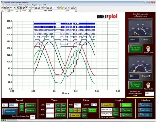

  • MakerPlot ($59) - digital & analog plotting, monitoring, custom interfaces and more.
    MakerPlot

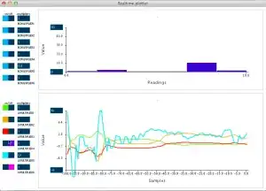

  • RealtimePlotter (free) - 6 channels data plotting.
    RealtimePlotter

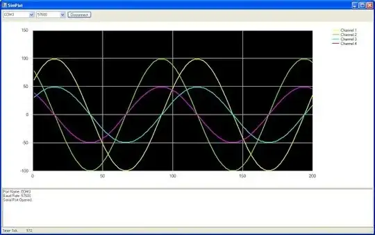

  • SimPlot (free) - 4 channel plotting.
    SimPlot

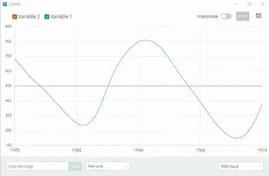

  • Arduino Serial Plotter (free) - built in Arduino Editor under Tools > Serial Plotter.

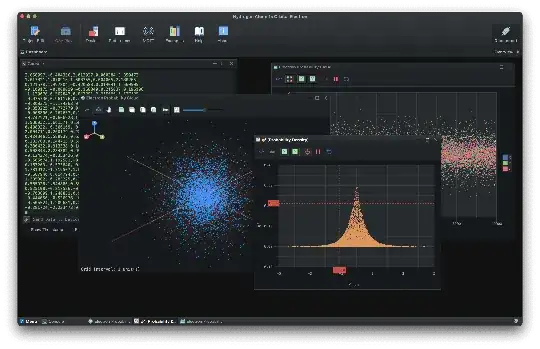

  • Serial Studio (GPLv3 source available; $9.99/month or $179 lifetime for full features; free 14-day trial) – cross-platform data visualizer for serial, TCP/UDP, and Bluetooth LE with flexible frame parsing, plotting, widgets, MQTT, checksums, built-in project editor and console/csv data export. Can replay previously generated CSV files.
    Serial Studio

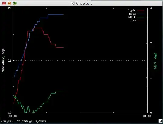

GnuPlot
Advantages: It's very flexible, scriptable, and freely available.
Disadvantages: A bit complex to learn (but I figured out how to get started in a few minutes, and quite functional in an hour or two), runs in a terminal window (if you consider that a disadvantage).
Something I found very useful was to script it to reload my terminal program's logfile periodically so i got a dynamic graph as my experiment progressed.
Image of GnuPlot
Edit: Here is the GnuPlot script that plots it:
#!/usr/local/bin/gnuplot -rv
# Note reverse video here ^^^   til I find a way to put it in the script
# gpFanCtl - Plots DiffThermo fan controller data (aloft, alow, Tdiff, fan-state).
# $Id: gpFanCtl,v 1.8 2014-04-28 09:40:51-04 jrobert Exp jrobert $
set terminal x11 1 noraise
set xtics 3600
set mxtics 4
set xdata time
set ytics 1 nomirror
set mytics 2
set y2range [0:3]
set y2tics 1
set my2tics 4
set grid
set ylabel 'Temperature, degC'
set y2label 'Tdiff, degC' textcolor rgb '#00CD63'
cd '/Users/jrobert/Desktop'
plot "Logfile.txt" using ($0*4):1 title "Aloft" with lines lc rgb "red",\
     "Logfile.txt" using ($0*4):2 title "Alow" with lines lc rgb "#3982FF",\
     "Logfile.txt" using ($0*4):3 title "Tdiff" with lines lc rgb "#00CD63" axis x1y2,\
     "Logfile.txt" using ($0*4):4 title "Fan" with lines lc rgb "orange" axis x1y2;
pause 4
refresh
reread

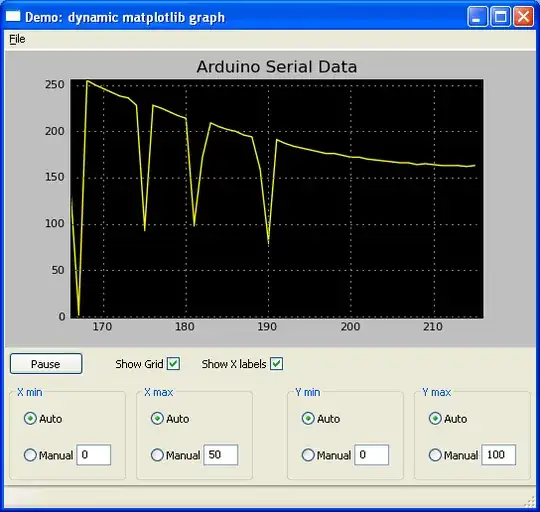

I use Matplotlib for any plotting I need to do.
It's not arduino specific in any way, but it is a very excellent Python plotting toolkit.
I've built a number of applications that plot data from a variety of microcontrollers in real-time to a graph, but that was really more of a two-step process: 1. Get data from device into computer, 2. plot realtime data.
Really, I think you should break your question into two parts:
  • How do you get data from an Arduino/Any serial device into a computer easily.
  • What is a good plotting library that is easy to use.

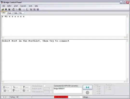

Responding to my own question here.. I use Bridge Control Panel as mentioned.
Advantages: Lots of Features.
Disadvantages: Tricky to setup and very poor syntax/error reporting.
To use: You need to write the Arduino Data over the Serial Port one byte at a time. For an int data type that would look as follows:
// RX8 [h=43] @1Key1 @0Key1
Serial.print("C");
Serial.write(data>>8);
Serial.write(data&0xff);
In Bridge the command to Read Data is:
RX8 is the read command [h=43] means the next valid byte is "C" in ASCII then the High Byte of Key1 then the Low Byte of Key1
It looks like this in Bridge:

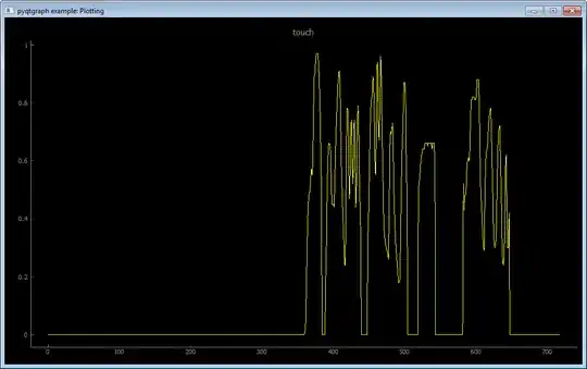

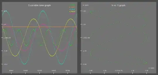

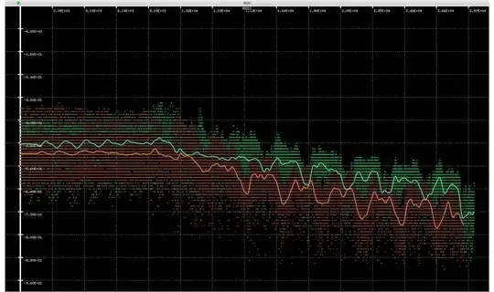

You might be interested in Telemetry See on Github . It is a communication protocol, highly simple to use, with a clean interface, that enables bidirectionnal communication with Arduino/Mbed devices.
If you don't want to read this long post, see A walkthrough of all the awesome features in it
The power of this library comes from the desktop command line interface (that requires no programming skills in python).
It is able to open high-performance plots (much higher that what can be done with matplotlib) just by typing a command.
The protocol supports complexes data structures. For now arrays and sparse arrays can be send from the embedded board.
The plots opened from the command line interface understand the type of data, and for arrays, rather than plotting each sample versus time, sample will be plotted against its own index.
In a near future, it is planned to add support for spatial coordinates (xyz data), that will allow you to plot immediately spatial data. Once, again the plots will figure everything out, plot your data in 2D or 3D space and you can focus on developping your app.
I believe those features are simply unique for such a project.

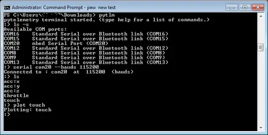

Pytelemetry CLI PyPI version
Once installed with pip, the command line can be started with
pytlm
Then you can connect, ls(list) received topics, print data received on a topic, pub(publish) on a topic, or open a plot on a topic to display received data in real-time
Get started
Wiki
PS : I am the author.
I developed it because I could not find a solution that would allow me to:
  • write quickly PC scripts to control an Arduino
  • debug quickly
  • plot complex data (not just a time varying value)
all of the above without using proprietary solutions or bloated GUIs.
Using this library, the time to setup a communication between Arduino and PC went from usually half a day to 5 minutes.

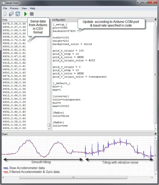

You can try serialchart. It's pretty strait forward program. It does exactly what you asked. The only disadvantage is that it requires data in CSV format (does not meet first point).
Screenshot from project page:
example

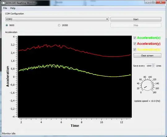

I made an equivalent tool in python that print real time data from ADXL345 accelerometer. https://github.com/mba7/SerialPort-RealTime-Data-Plotter
may be it will be helpful for someone
Just choose the serial com and speed and sent a serial data on the following format:
  • 3 inputs, every input is a 2 bytes (Two's complement )
  • 6 bytes seperated by a space
  • the packet is a string terminated by '\n'
Could be easily adapted to change this format

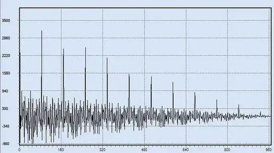

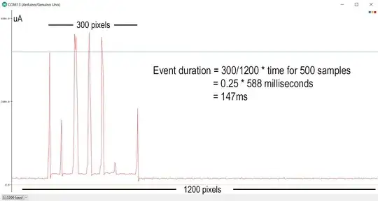

I know you were probably after more advanced GUI output, but I managed to replicate a task that one would normally do with an oscilloscope: Arduino Serial Plotter output
using the serial plotter in the Arduino IDE and an ADC module you can get for $3 on eBay. I admit it's a bit crude, but it might be worth playing with the tool for a while, before you invest in Python/Matlab/ect level solutions. It was exceedingly easy to use. It would not take much to add SD card recording to the process.
See: https://edwardmallon.wordpress.com/2016/08/15/using-the-arduino-uno-as-a-basic-data-acquisition-system/

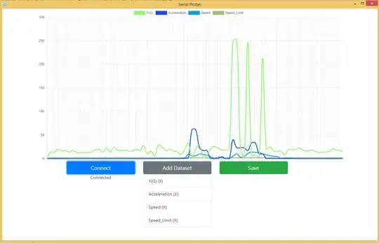

Serial Plotter is a simple program that I've made with Electron that receives data in the following format: data1,data2,timestamp; and converts it into a realtime chart.
user2298995
  • 111
Almost useful. It needs:
  1. logging serial data to a file OR
  2. graphing from a file and updating every xxx milliseconds.
Live Graph is a better option and I use it in conjunction with Tera Term which gets the data via the USB/serial link (and saves it to a log file which then Live Graph polls).
Live Graph is slightly buggy when caching data and I haven't found a way to set a moving window to display results. Also, showing multiple graphs requires manual scaling, but in spite of all this, it's still very useful. It's written in java so you'll need the JRE. I prefer this over having to install python like some of the other graphing programs do. another downside is that it opens 4 different windows, which is a pain when I want to flip between it and Tera Term.
I've yet to find software that's
  1. An executable (.EXE) so it has no external reliance
  2. Includes a terminal emulator or serial data logger
  3. Logs serial data
  4. Graphs multiple items from a CSV
  5. Allows for CSV AND tab-delimited data (which is way easier to read as it scrolls along while simultaneously monitoring the graph.
  6. Allows setting of different scales for each overlaid graph without having to scale everything to [0..1] or setting a multiplier, i.e. allowing setting an [y0..y1] range for each item graphed.

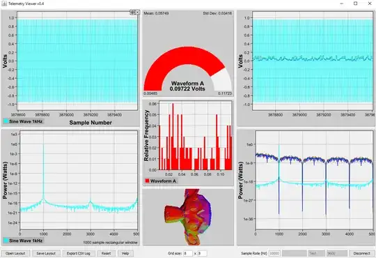

Telemetry Viewer
Advantages:
  1. Easy to use
  2. Intuitive and flexible UI
  3. Open Source and free
  4. Different types of Graphs
  5. Very fast graph update rate
Disadvantages:
  1. Stopped development
  2. Binary data format is not complete yet.
  3. Primitive graph controls like zoom, screenshot and ... enter image description here

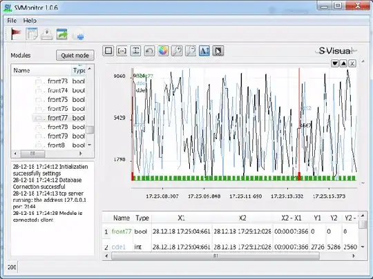

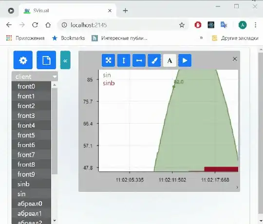

SVisual Monitoring and recording of signals for Arduino and not only.
Video example
Download (free)

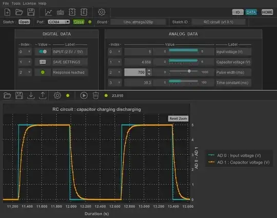

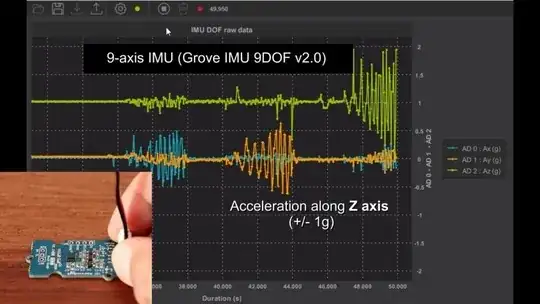

HITIPanel Serial data plotting and recording. You can zoom in/out, pan, export data to text or excel file, or import external data from text files. Come with a user interface to control and monitor the hardware.
