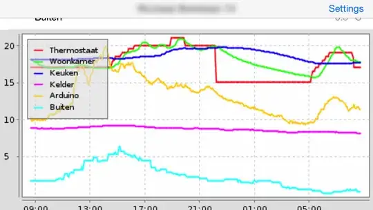

Presuming you want to get results quickly, I recommend you have a look at openHab This is a Java based home automation framework and server that has plugins for many existing protocols.
Once you get your protocol running it is just a matter of plugging it into openHab for charting and storage. I use for inside home measurements: enter image description here
