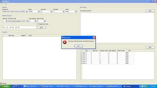

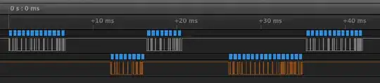

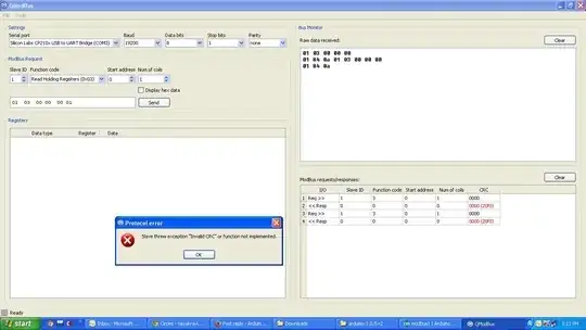

I have the below code. This code is successfully compiling and uploading, but I am not getting any response from Slave. What do I need to do?
Error message
Connection diagram
Some time data being received from Slave (I get this error): error2

My testing indicates that the slave is responding. I made up a master from http://playground.arduino.cc/Code/ModbusMaster and tested it:
Modbus response
  • Channel 0 is master to slave.
  • Channel 1 is slave to master.
Zooming in:
Modbus response 2
Nick Gammon
