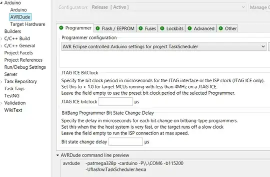

  3. Use another IDE, something that deserves the IDE name. I use Eclipse with this Arduino plugin and it works fine for me. As a bonus, avrdude support seems better as you can see on the screenshot below:
