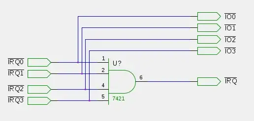

In my project I need to connect more then 10 I2C sensors(MPU-6050) to Arduino Mega and an interrupt line for each sensor is essential. Since the Arduino Mega only has several interrupt slots (digital 2, 3, 21,29,19,18), how can it be achieved? Is that using a multiplexer every time I switch sensors and also switching interrupt lines solve the problem?
The code I'm using is Jeff Rowberg's MPU-6050 DMP example, which means interrupt line is essential and important, also very sensitive (a wrong change can cause sudden stop)..

One possible solution is to use a "global" interrupt pin which all the sensors use, and also normal GPIO pins to work out which interrupt has occurred.
Feed the interrupt signals into a multiple-input OR gate (if they are active HIGH) or a multuple-input AND gate (if they are active LOW). The output of that AND gate goes to a single INT pin. Each interrupt signal also goes to a normal IO pin. When the interrupt pin triggers the ISR can then look at the IO pins to determine which of the interrupt signals that triggered the interrupt.
For fastest operation use IO pins that are on the same port and use direct register reading for that port to see which bits are on and which are off.
Majenko
  • 105,851
  • 82
  • 139
Just FYI, the interrupt is not essential. If you can write efficient code you can read an MPU(DMP) without it (UNO, been there, done that). But that is only for one MPU. I doubt if an UNO can keep up with 10, no idea about the faster processors. In any case, even with interrupts, I doubt if an UNO could keep up with 10. Keep googling and you will find a note how to change the sampling rate to slow the MPU down.
The code you referenced provides AHRS (Attitude Heading Reference System) - I would be real curious to see what projects needs 10 of those :) Sounds like fun.
