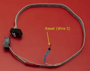

To answer my own question, just to report that I found something close to what I was looking for, which I link and describe briefly below.
Gammon Software Solutions forum - Atmega Bootloader Programmer - Programming Cable
On that page, the author suggest that we cut pin 5 from the 6-pin ICSP programming cable, solder a pin to it, and wire it to pin D10. Like so:
Modified ICSP programming cable
Then, you can load the Arduino Uno with the ArduinoISP sketch and program the target board as usual.
