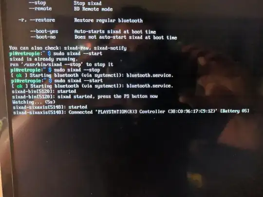

  11. Type in sudo sixad --start, if it says already started then type in sudo sixad --stop. Now type in sudo sixad --start, press "PS" button for the sixad to find your controller. If it finds it will say so and show its id number and say waiting for input. This lets you know that it found. Looks something like this.enter image description here
  12. Now press ctrl+c to cancel the app.
